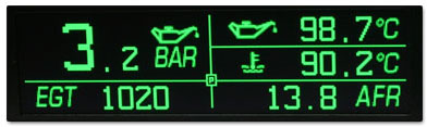

UTCOMP can read signal from EGT-K and show temperature on display. You can set also alerts for to high exhaust temperature. It has also data logger feature.

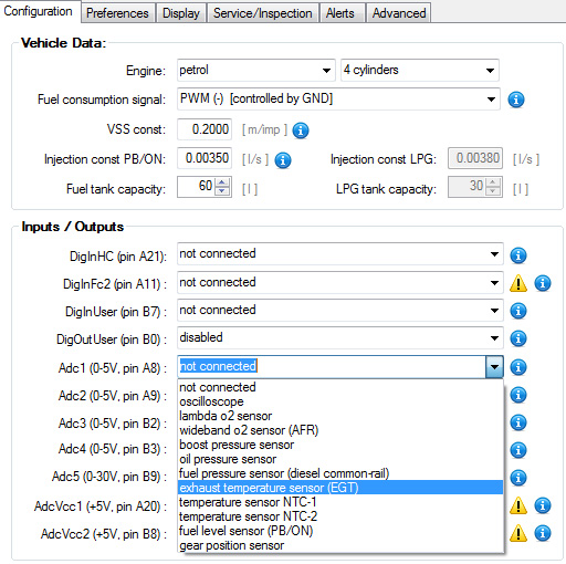

First of all, you need to connect EGT-K output to any 0-5V analog input in UTCOMP (AdcX) and configure input in UTCOMP application:
Secondly, you need to configure EGT reading. Go to advanced settings and provide calibration data for EGT-K:
a = 250.0, b = 0.0

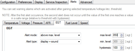

Finally, you can set customs alerts :-)
