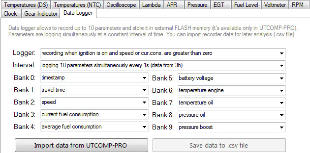

Example data-logger settings in UTCOMP application:

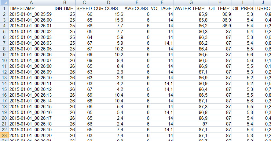

Example raw data imported from UTCOMP-PRO (screenshot from Excel):

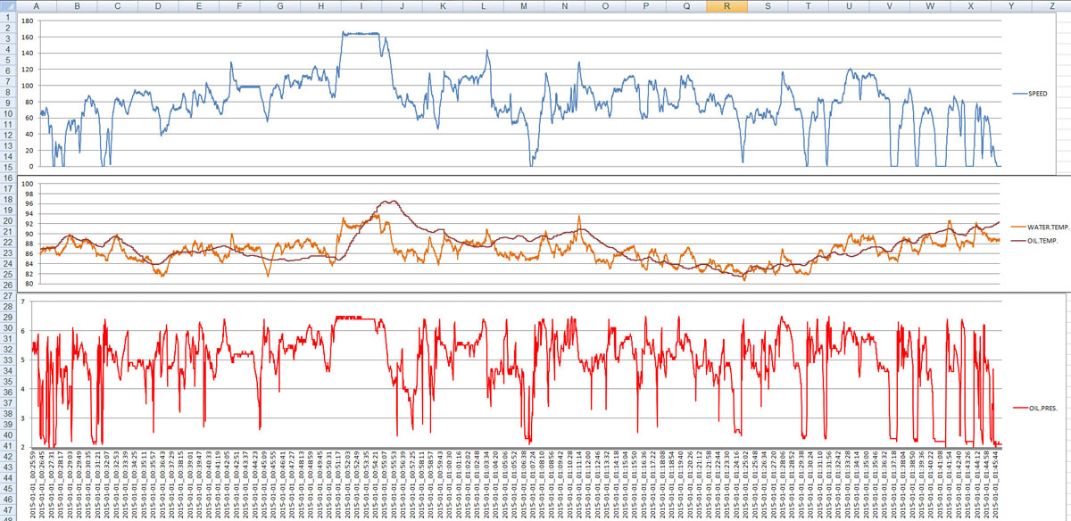

And something more interesting - data visualisation on charts (distance ~100km):
Quick interpretation: as you can see, oil temperature is rising quite fast on a constant high speed (cruise control is switched on) - from about 85 celsius degrees to 96C. What is more important - oil pressure is always on high level (over 6 bar). You may notice that engine (water) temperature have quite big oscillations - it is not stable as it should be - it may indicate problems with thermostat or cooler or... this is not bug, it's feature! ;)

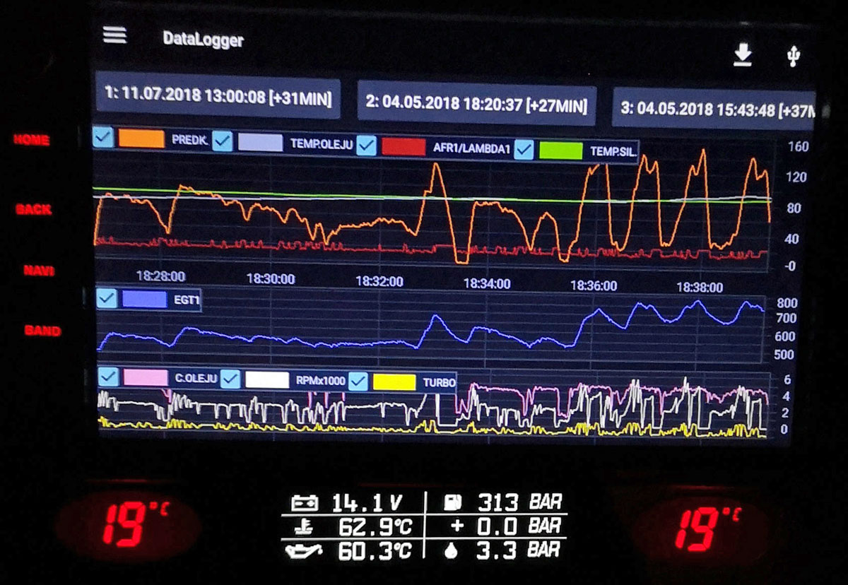

Now you can import data logs on your Android device!
Please take a look here:
viewtopic.php?f=28&t=408

You can activate data logger in settings -> advanced -> data-logger.
You can enable it:
- always when ignition is on or
- only when speed is greater than 0 or
- only when engine is running

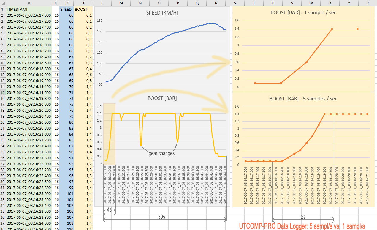

Data logger now can record up to 5 samples per second for boost pressure, oil pressure, AFR (both channels) and EGT (all channels). On example picture is comparison between 1 sample/sec (1Hz) recording and 5 samples/sec (5Hz) recording for turbo pressure (acceleration for 30 seconds, zoomed in first few seconds). New feature will be available in v3.5 update.

Every time you start/stop datalogger manually it's creating timestamp. It's recommended to use Android UTCOMP application to download logs because it loads data in time frimes and you have nice charts for preview, please check this:
