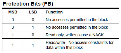

First 9 bytes in APP register are configuration bytes with Protection Bits (PBx). When protection bit is 1, than assess is permitted in the block. When protection bits are 0, than read and write are NOT possible (block is read/write protected):

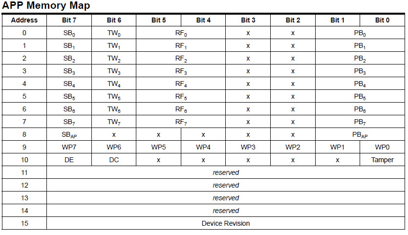

Here is an APP Memory Map:
All PBx bits should be set to 0 to unlock the device.
Additionally all WPx bits should be set to 0 to unlock write for all pages within block 0.
