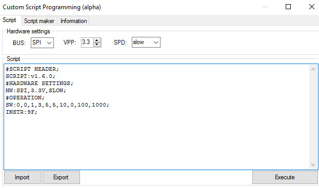

Example construction of typical script with header (software version v.1.6.0), hardware settings (SPI bus, 3.3V voltage, slowest speed) and single operation with 1-byte 9Fh command.
Code: Select all
// example script construction
#SCRIPT HEADER;
SCRIPT:v1.6.0;
#HARDWARE SETTINGS;
HW:SPI,3.3V,SLOW;
#OPERATION;
SW:0,0,1,3,5,5,10,0,100,1000;
INSTR:9F;

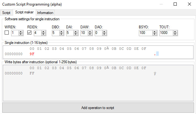

Script maker
Script maker will help you prepare multiple operations with correct syntax.
Software settings for single instruction:
  • WREN (Write Enable) + number of bytes to write in single operation,
  • RDEN (Read Enable) + number of bytes to read in single operation,
  • DBO (Delay Before Operation) - optional delay in miliseconds before operation,
  • DAI (Delay After Instruction) - optional delay in miliseconds after instruction,
  • DAW (Delay After Write) - optional delay in miliseconds after write,
  • DAO (Delay After Operation) - optional delay in miliseconds after operation,
  • BSYO (Busy Operation) - maximum time in miliseconds for write end (e.g. maximum wait time for busy flag in FLASH SPI or for ACK in I2C devices)
  • TOUT (Timeout) - maximum PC timeout in miliseconds for operation end (it is recommended to set timeout greater than sum of all other delays).
Operation code generated by script maker from above example::

As you can see SW parameters are equal to script maker parameters:
Code: Select all
SW:WREN[0-1], WriteLength[0-255], RDEN[0-1], ReadLength[0-255], DBO[0-250], DAI[0-250], DAW[0-250], DAO[0-250], BSYO[0-n], TOUT[0-n];

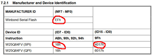

Please take a look at Winbond W25Q64FV datasheet (page 21)
First byte is manufacturer ID (EFh means Winbond), second byte is device family (40h means W25Q... family) and third byte means device capacity (17h means 64Mbit device). Fourth byte 00h is not supported by Winbond (it is extended device id used by some manufacturers).

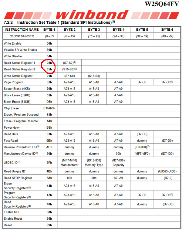

We have changed instruction from "9F" to "05" and set only 1 byte length for read to read single byte SR1 register. For SR2 we need to change instruction byte code to "35" (other parameters are the same)
As a results we read 2 bytes: 00 (SR1 register) and 02 (SR2 register)

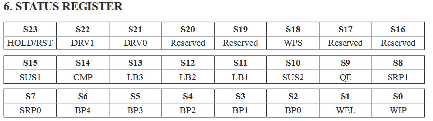

and it means that device has enabled QSPI mode (QUAD SPI) because S9 bit is set (1):
Write SR2 register for FLASH SPI:
Let's say we need to disable QSPI mode. We need to change SR2 register (reset S9 bit). For Winbond W25Q series there is required to write SR1 and SR2 registers in single operation to success (please check device data sheet page 28 - Write Status Register (01h)).

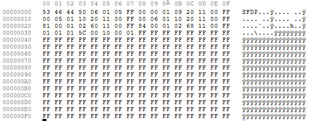

Read SFDP data table for FLASH SPI
Code: Select all
#SCRIPT HEADER;
SCRIPT:v1.6.0;
#HARDWARE SETTINGS;
HW:SPI,2.8V,SLOW;
// SFDP 256 Byte table read (5A + 3B start addr + dummy byte + 256B read)
#OPERATION;
SW:0,0,1,255,5,5,0,0,100,500;
INSTR:5A,0,0,0,0;
Results for Spansion S25FL512SA (512Mbit FLASH SPI 3V):

QuadEnable (QE) is bit 9 (S9).
S9 is placed in Status Register 2 (S15-S8).
You can read it with 35h command:
So your read instruction is correct.
00h means that all bits (S15-S8) are zeros, so QE is disabled also.
To enable QE you need to set S9 to "1"
So Status Register 2 (S15-S8) should has binary value 0000 0010, which is 0x02 in hex (you can use windows calculator for conversion between binary and hex if you not familiar with that).

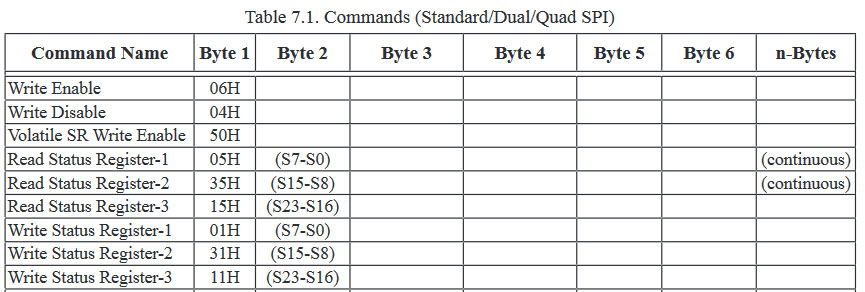

So you need to write 0x02 to Status Register2.
Write Status Register 2 command is 31h (table above).
But, here is the tricky. Before you write status register you need to unlock the device (write enable command)
