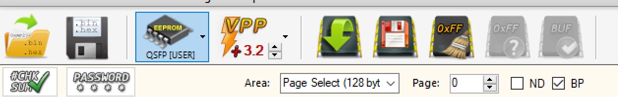

I had few similar cases, it can be 2 reasons:
1. there are few passwords with different access levels - you have found password which not allows for permanent changes - you need to search next password with higher priviliges
2. please try to write to single page of qsfp and byte by byte, you can do that by selecting QSFP[USER] and then select Area: Page Select (128 bytes), select page 0 and check "BP" checkbox. Please note that each page has 128 bytes and it will be second 128 bytes from standard 256 bytes read so please read single page before overwriting it (more details about memory map viewtopic.php?f=32&t=529 upper page 00h). You can also try single page write without BP checkbox. Any difference?
2022-07-22 130709.jpg (59.05 KiB) Viewed 188577 times
Please let me know if it helped.

ArT wrote:I had few similar cases, it can be 2 reasons:
Thanks for the reply! The single page/byte-by-byte had no effect. I think you're right about the access levels. The password that was found was 0xABCD1234, so it makes sense that it would be something like a test password. I'll let you know when the second password is found.

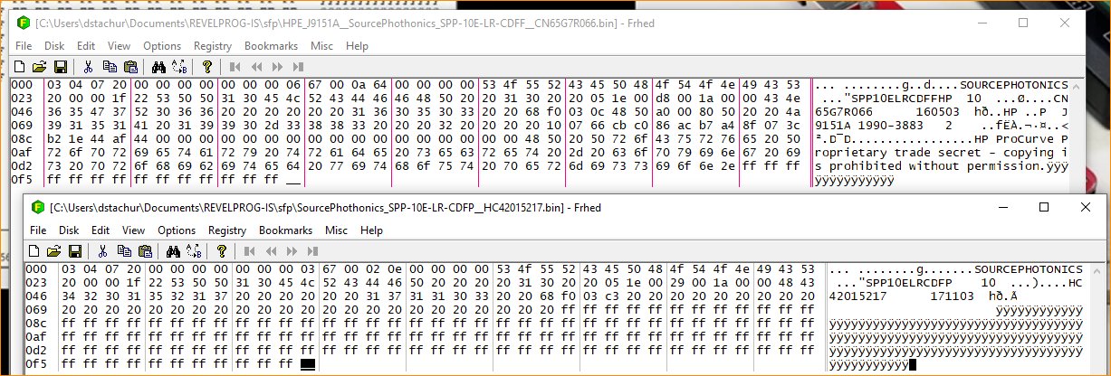

> Out of concern about human rights abuses and infringement political freedoms in China, we would prefer to avoid transceivers manufactured there
I like your way! I would suggest Source Photonics which I believe belongs to SkHynix, but unfortunately these are protected and I did not find an manufacturer password :-/
My issue is related to HP Aruba SFPs - Aruba (formerly HP) network devices accept only HP marked SFPs. I am working on some project currently and I need quite a lot of 10G Single Mode SFP for HP Aruba devices (HP p/n J9151A). I bought an original J9151A and found it is not a Finisar as it was previously, but Source Photonics. So, I found these Source Photonics on eBay with an idea to reprogramm all of them using original HP microcode to convert these to HP J9151A. Unfortunately none of my known manufacturer passwords worked, so I spent about 18 days trying to brute force Source Photonics SPP-LR-CDFP. I tried 80000000-FFFFFFFF and 00000000-7FFFFFFF with no luck... Standard 00001011 pass is working as user password only which doas not allow me to write J9151A.
I was wonder how this is possible I did not find a correct password sequence? Is there possible some newer concept of securing SPFs? Similar to what we have for account lock after a few incorrect passwords? Do you guys think such mechanism would be tweaked by i.e. fully disconnecting SPF after each unsuccesful sequence?
