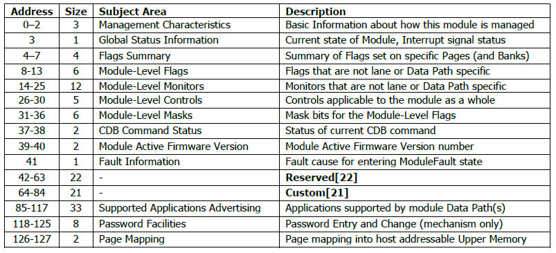

Lower Memory Map Overwiew (00h-7Fh)
CMIS Module Lower Memory Map from OIF-CMIS-05.2 specification
As mentioned before bytes 126-127 (add 7Eh and 7Fh) are responsible for bank & page mapping. When you overwrite byte 7Eh you will select bank number. When you overwrite byte 7Fh you will select page number. For example, when you set Bank=00h and Page=00h in bytes 127-128 you can read administrative information from Upper Memory bytes 129-256 (manufacturer name, vendor name, s/n, part number, revision etc.). This area is selected by default and is supported by all transceivers.
