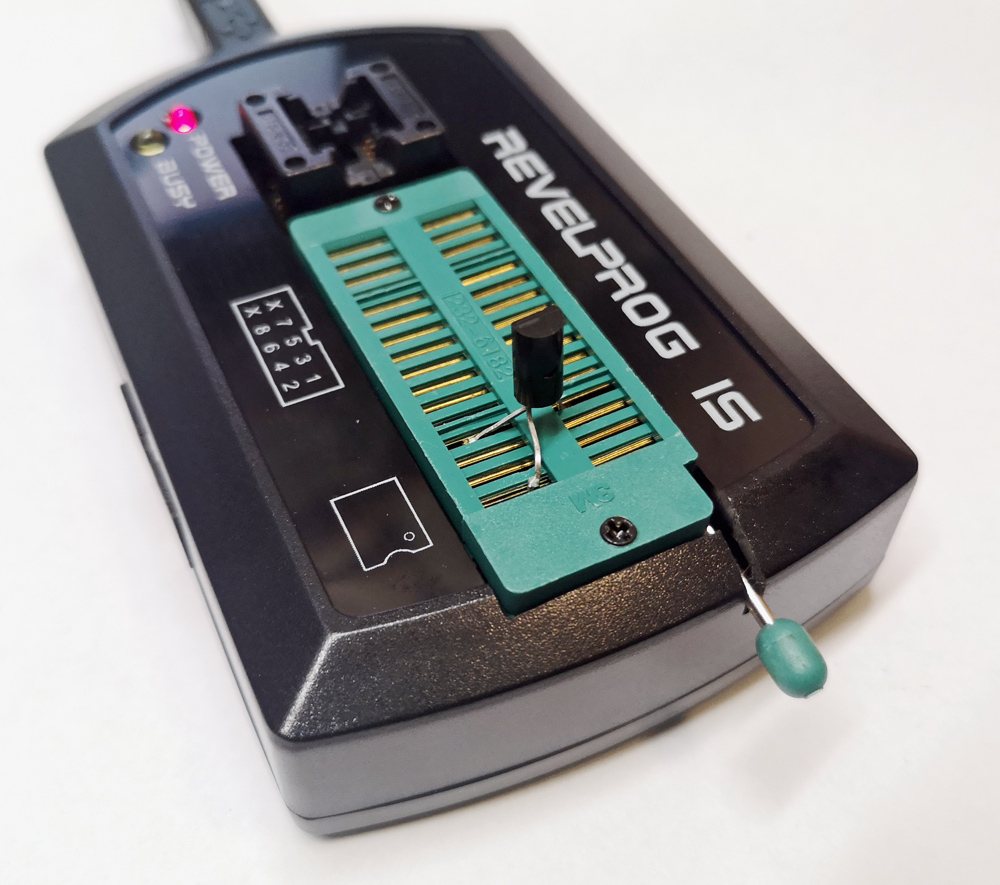

REVELPROG-IS since v1.8.5 is supporting DS2434 Battery Identification Chip. It's older version of DS2436 Battery ID/Monitor Chip which is already supported - there are only small differences (please check programming procedures for DS2436 here viewtopic.php?f=32&t=436). Both battery chips are using 1-Wire interface and has 160 bytes of memory divided to 5 pages. I'll be using custom scripts for custom script tool in REVELPROG-IS.
DS2434 is 1-wire device with 16-bit unique ID, 2-byte battery cycle counter, A/D converter for battery temperature monitoring and 32 bytes eeprom for user data (total memory area is 160 bytes divided to 5 pages, but not all bytes are used).
Connection requires 3 wires:
- ground (pin 4 in programmer),
- data line (pin 5 in programmer),
- vdd (pin 8 in programmer)
This is how I connected it with REVELPROG-IS socket but you can also try to programm it in external circuit.
Below are ready to use scripts for REVELPROG-IS.
You can read more about Custom Scripts Programming here: viewtopic.php?f=22&t=280
