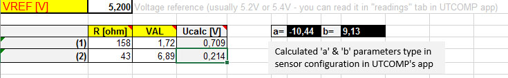

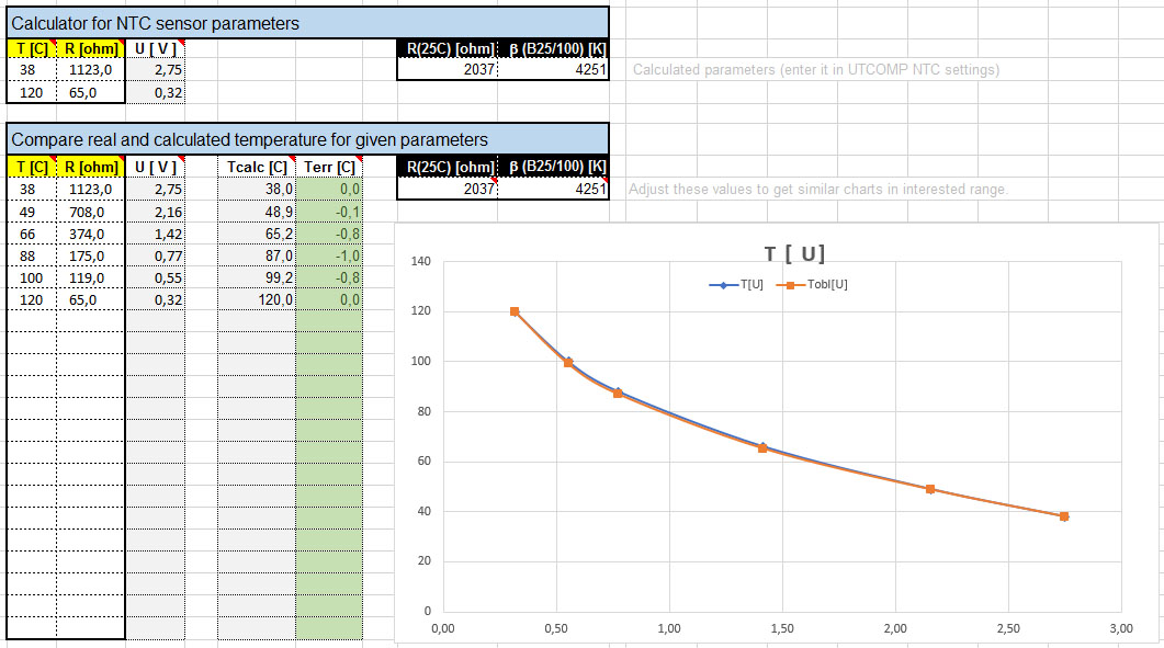

I calibrated temperature sensor based on resistance - when sensor is connected ONLY to AdcVccX in utcomp (and disconnected from other gauge), than R25 = 2037, Beta = 4251 and error <1C.
For pressure sensor it should be first translated to bar:
250 ohms = 0psi = 0 bar
158 ohms = 25psi = 1,72 bar
111 ohms = 50psi = 3,45 bar
75 ohms = 75psi = 5,17 bar
43 ohm = 100 psi = 6,89 bar
and it seems that you have wrong measurements because it is not linear in whole range (and it should be):
I can linearize in range of 2-7 bar but error will be about 0,2-0,3bar:
in such case a = -10,44, b = 9,13
and again - sensor should be connected only to AdcVccX in utcomp (and disconnected from other devices)
If you would like to use the sensor on multiple gauges, than please share real voltage tables.
I'll help you to scale it 8-)
