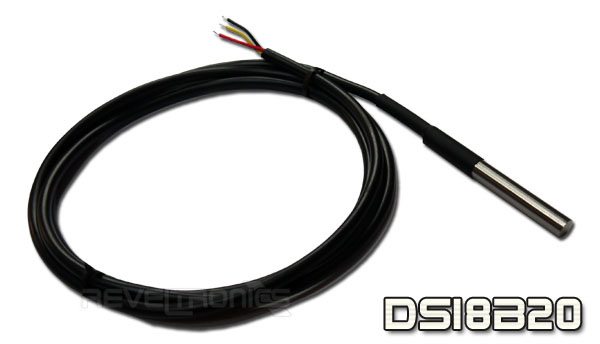

You can also buy waterproof variant of these sensor where sensor is inside stainless steel tube:
Advantage is fast and easy assembling. Such sensors are also very reliable.
Disadvantage is not so fast response for temperature changing.
