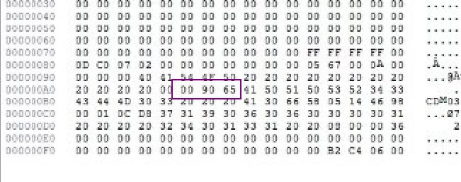

One more suggestion, we needed to change vendor OUI for our QSFP to work properly
Im attaching picture of right place if someone want to change it.
It will be easier if you find place for it on top, to be changed like vendor/part number/revision and etc, so no need to edit hex directly ;)
