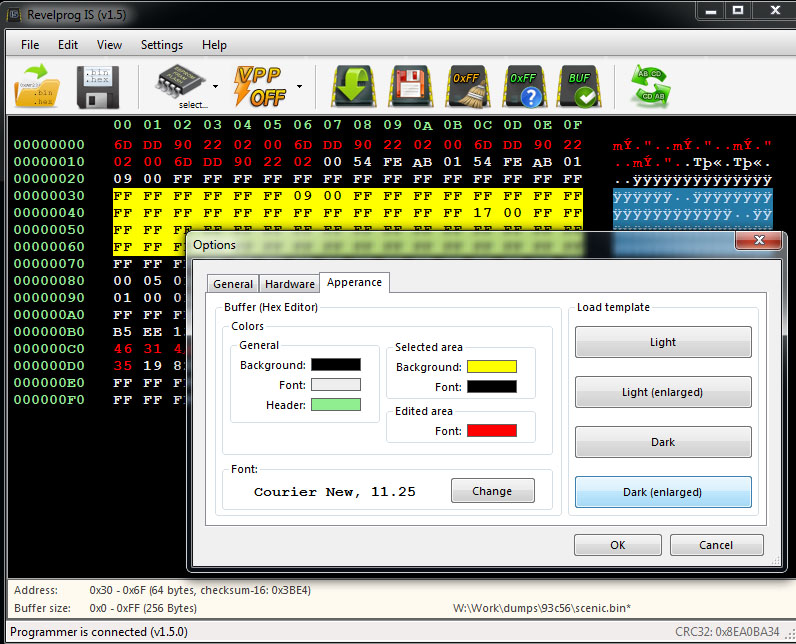

  • Appearance customization
    New 1.5 version introduces also cosmetic changes. Now there is possibility to personalize hex editor, e.g. color and font changes. Bigger font and dark contrast colors will enhance your work with editor especially on high resolution displays:
  • Modified bytes in buffer
    As you can see on above picture, edited bytes now are highlighted with different color.

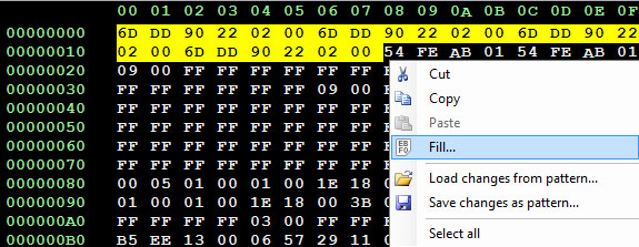

  • Fill buffer...
    We added "Fill" option to the buffer (in context menu):

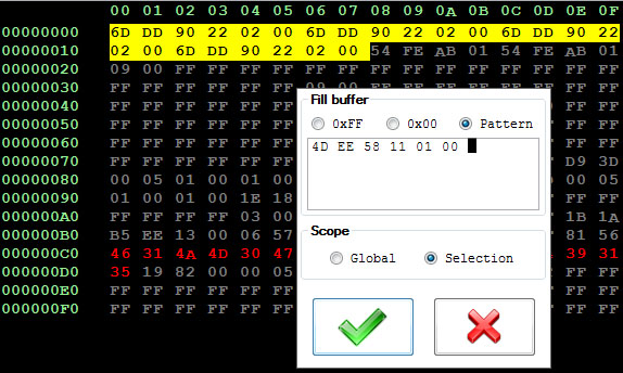

    This feature is very helpful when you need to fill selection area with constant bytes (e.g. 0x00 or 0xFF) or with specified pattern. Here is an example of filling mileage in Renault instrument cluster (please note that mileage is repated 4 times in selected area):

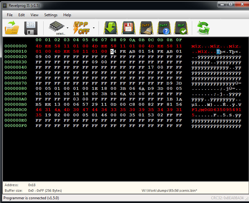

    And here is result...

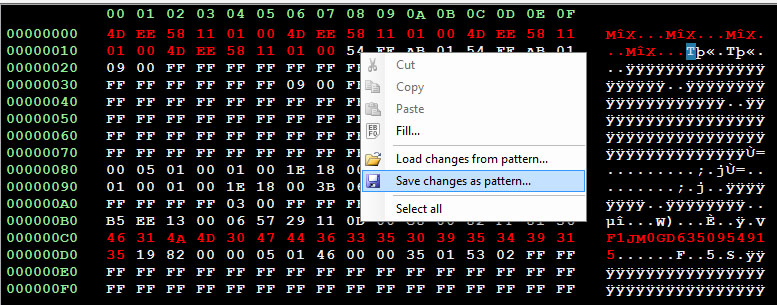

  • Patterns
    This is awesome feature and you will love it!
    All manual changes (highlighted bytes) can be exported to external file (pattern):
    Later, at any moment there is possibility to load pattern file and all changes will be imported, without modifying other bytes in the buffer. It can be very useful e.g. during editing VIN, mileage, crash data etc. (anything) - just save edited data to external file (as pattern). In next instrument cluster, ecu, airbag etc. just import your pattern file and changes are done, it's simple, fast and powerful!
