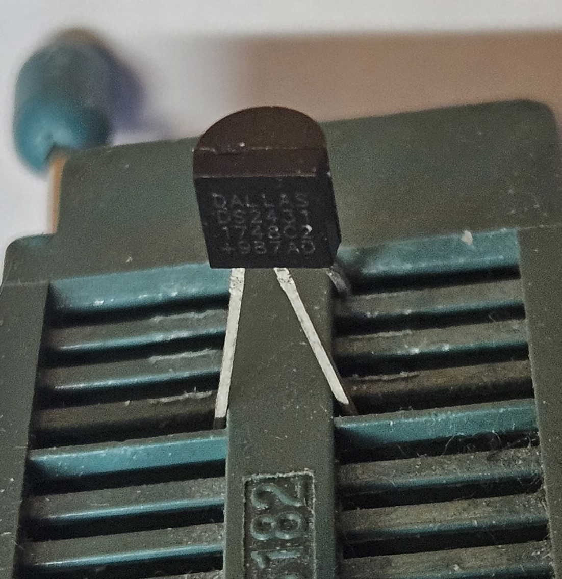

The Dallas DS2431 not so much. Here is the link to images: https://drive.google.com/drive/folders/ ... sp=sharing
I tried all combinations of two pins to Pin 4 and 5, but none can get connected.

I ordered DS2431, tested it today and everything is working fine with v1.9.1
Pin4 and Pin5 from programmer are enough for read/write/erase.
You can send to me your chip so I can check where is the issue, with chip or with programmer.
