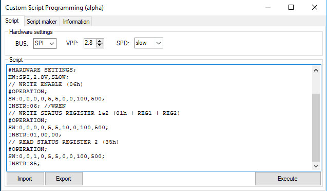

Custom Script Programming for I2C/SPI - we spent a lot of hours on this powerful tool. It is still in developement phase, but it already gives huge possibilities. You can write script to execute any commands e.g. for unlocking device, read and write hidden registers, change protection and OTP bits etc. We will describe full functionality in other thread (check it here).

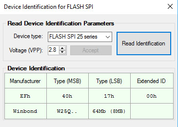

Device identification for FLASH SPI (Chip ID / Read ID). We had concerns to release this tool earlier. REVELPROG-IS supports also low voltage chips so reading chip ID without knowledge about chip power supply level is risky (setting 3,3V for 1,8V chip will damage it even during chip id reading). That's why it is required first to set and accept VPP level. Please use it carefully (you should check absolute maximum rating for chip or power supply level on the chip in external circuit).
