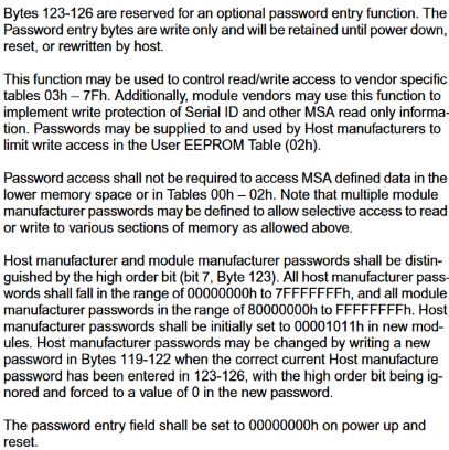

MSA Standard password types
Host/User Password
Host password is protecting User Writable EEPROM area - if you know password you can modify only user eeprom. Location of this area vary depends on transceiver type, e.g. for SFP it's page 0 in block A2h, for QSFP it's page 2 in block A0h, for XFP it's table 2 in block A0h (please check MSA Standard specification for SFP/QSFP/XFP, e.g. SFF-8472, SFF-8636, INF-8077i for more details). In most cases user can change this password (if current password is known). All factory new transceivers should have default host password: 00h 00h 10h 11h
Manufacturer Password
Manufacturer password is protecting whole memory map, e.g. serial number, product name, manufacturer name etc. - if you know manufacturer password you can modify anything. Only manufacturer know this password and they do not want to share it with anyone.
Password location
Password is 4 byte length and should be entered in:
  • Block A2h, offset 7Bh for SFP / SFP+
  • Block A0h, offset 7Bh for QSFP/QSFP+ and XFP
In REVELPROG-IS it is dedicated function for entering password:
Unlocking QSFP / SFP / XFP transceivers with password
When you enter valid password you will unlock transceiver. Valid manufacturer password will unlock whole EEPROM. Valid host password will unlock only user eeprom area.

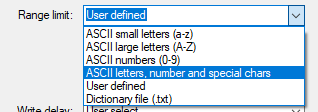

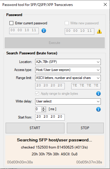

For host password it's recommended to search only ASCII letters, numbers and special characters (you can limit searching range) so in worst case scenario you will need to check ~81 millions of combinations. Please note that based on MSA standard default host password should be 0x00 0x00 0x10 0x11 for all new transceivers.
For manufacturer password you will need to check all combinations, but based on MSA standard it should be in range of 0x80000000 to 0xFFFFFFFF so in worst case scenario you will need to check ~2 billions of combination. You have no real chances doing it manually, but with REVELPROG-IS password tool for SFP/QSFP/XFP it's possible. It's not easy, but possible.
REVELPROG-IS is very fast programmer - all depends on transceiver speed. Programmer has implemented smart procedures so it's adjusting brute force speed to work as fast as possible with different modules. For most transceivers it will search about 300 passwords per second, so to find host password (ASCII chars only) you will need about 3 days (worst case scenario). For manufacturer password it's more complicated, because you have a looooot of combinations (2 147 483 648 to be specific :twisted: ), even if it's checking ~300 passwords/s you will need about 100 days to check all combinations. But MCU based QSFP+ & SFP+ transceivers with FRAM or FLASH (EEPROM emulation) are much faster, so you can make use from REVELPROG-IS real potential. Maximum search speed (from tests) it's about 4000 passwords per seconds, so you will need less then 6 hours (worst case scenario) to find host password and about 5 days (or less if you have luck 8-) ) to find manufacturer password.
Searching SFP host password with maximum speed (fastest SFP transceivers)
It's really fast for a such huge number of possible combinations. And you do not have to check all combinations - if you have any information in what range will be password you can limit this range.

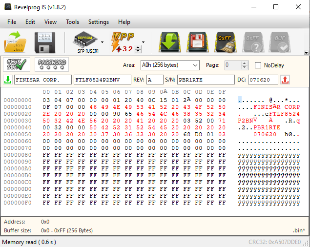

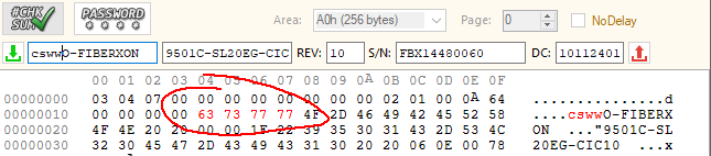

For example, SFP Finisar FTLF8524P2BNV - it took 29 hours to find manufacturer password (checking all combinations). Sorry for screen in Polish, but it was searching password on few computers and Polish language was set:
SFP FINISAR_FTLF8524P2BNV found manufacturer password
With known manufacturer password you can edit serial number, product name, vendor name etc. You can edit all EEPROM area.

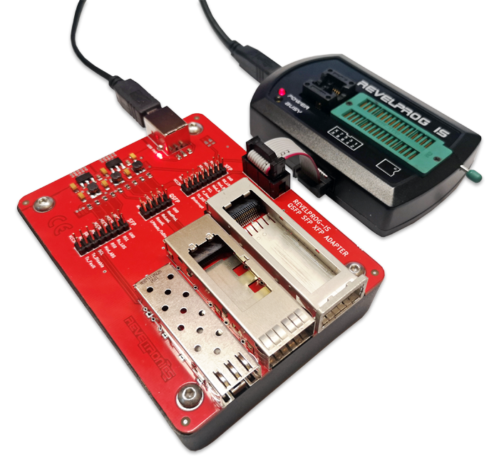

Tools used in this tutorial (REVELPROG-IS programmer + QSFP/SFP/XFP Adapter)
In this tutorial I used REVELPROG-IS programmer with dedicated Adapter for QSFP/SFP/XFP transceivers.
Adapter for QSFP SFP XFP transceivers and REVELPROG-IS programmer

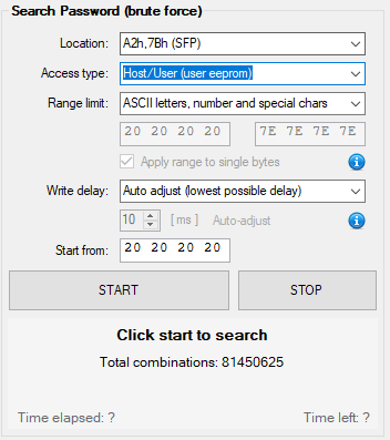

In incomming update v1.8.4 (available soon!) there are many improvements for SFP/QSFP/XFP Password Tool. Thank you all REVELPROG-IS Users for their suggestions how to improve this tool and make it more and more useful.

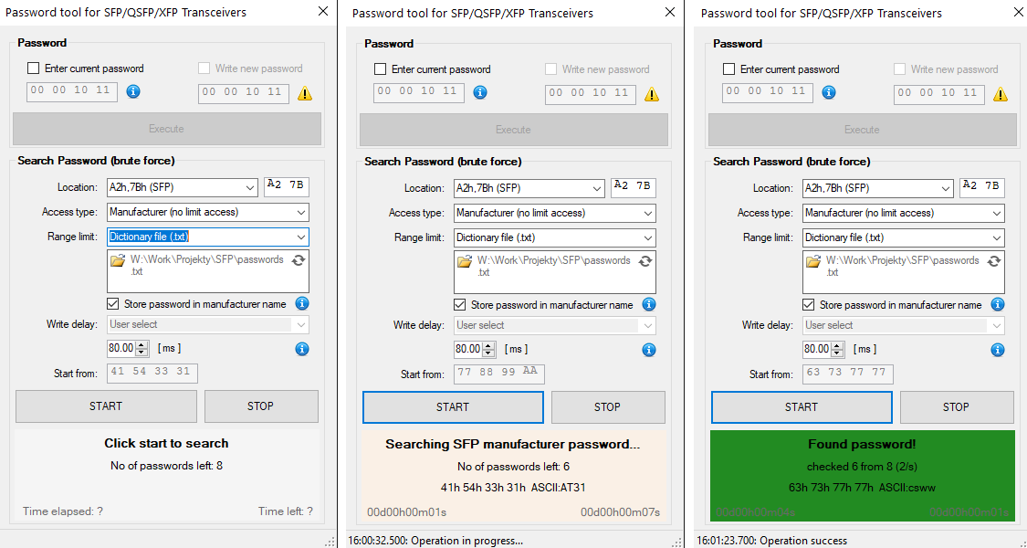

1. Added possibility to import passwords from dictionary file - if someone would like to check only specific passwords, he can list them in TXT file and import this file in application:
Password file should be in .txt format and should contains 1 password per 1 line as hex values, for example:
Code: Select all
00001011
00000000
FFFFFFFF
80000000
63737777
10011100
2. Save found password in manufacturer name
By default when programmer find password it overwrites first 4 characters in manufacturer name. This may be helpful when you left computer working for few days and something bad happen (e.g. computer freeze) so you can check if password was found. Since v1.8.4 this feature can be disabled with checkbox (see screenshots above) and original manufacturer name will be restored.

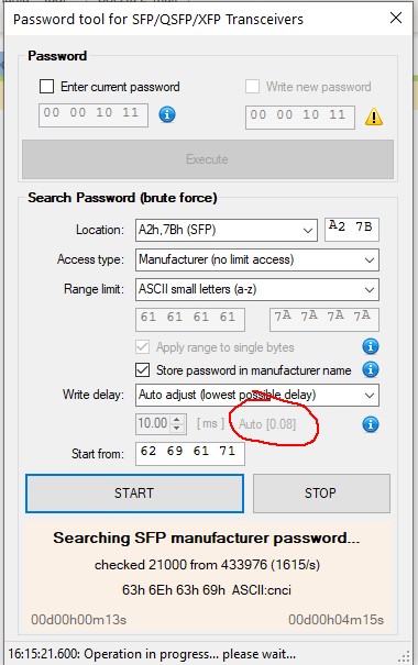

3. Improved auto-adjust for write-delay time
Now auto-adjust works better. In more cases it's able to detect lowest possible delay at which it will be able to detect valid password. Still it's not possible for all transceivers, but in most cases it works fine. If you see that auto adjust set write delay time to 0.00ms you should not trust it because it may skip valid password during search (some transceivers are operating on RAM and in such case auto adjust will not work). But if you see it's e.g. 0.1ms or 1ms etc (value greater than 0) than it's probably fine. You can preview which value was set here:
Anyway, MSA standard recommends to use write delay 80.00ms. It guarantees that you do not skip valid passwords. But with 80ms delay searching password will take ages, so for first loop you can try with autodelay (if it set >0.01ms). You can also set manual delay to 0.10ms / 1.0 ms / 10ms if autodelay does not work (pick lowest value where you do not have timeout). REVELPROG-IS is using smart alghoritm for low delays using weak points of physical EEPROM/FLASH memory so in most cases you can find password with success using very small delays (e.g 0.1ms). If you do not find password with this delay you can try with 80ms and limited range e.g. to ASCII characters (because I guess you do not have 10+ years to check all combinations).
It's always good to start searching password by limiting range to ASCII characters - e.g. 0-9 digits or small/big letters(a-z & A-Z) because there is quite big chance that manufacturer set password using console and keyboard ;)
