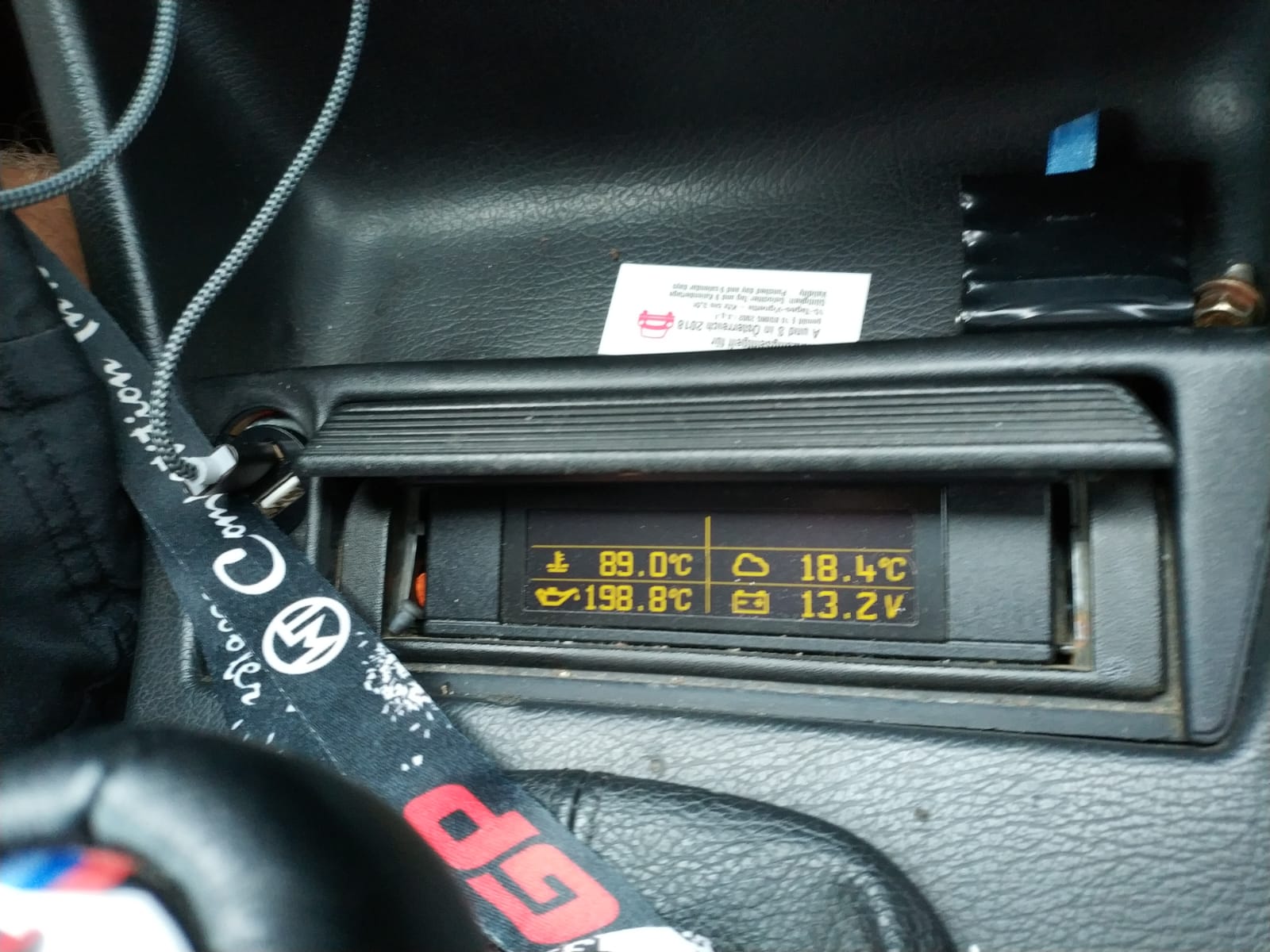

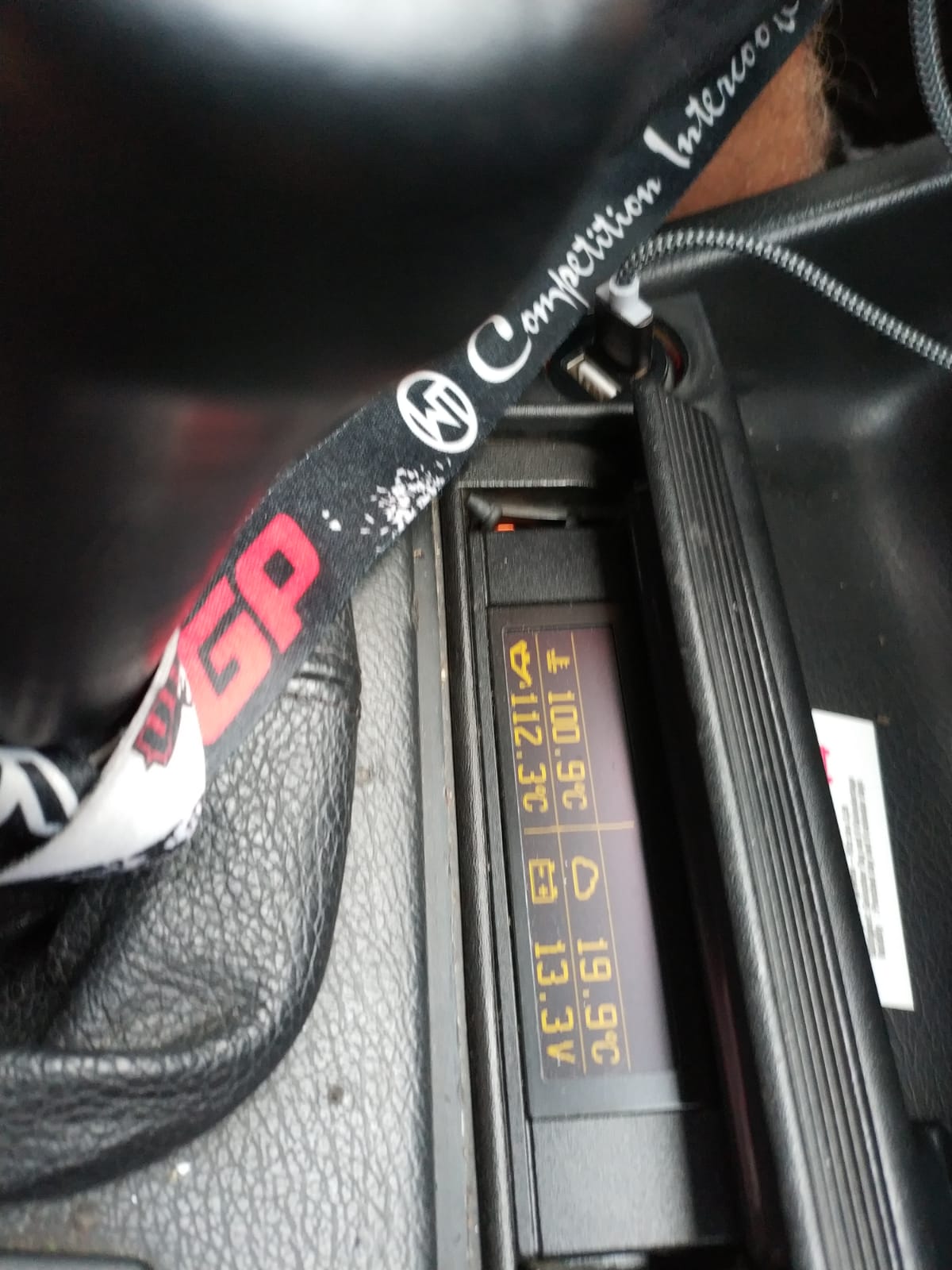

I got a problem with my utcomp Pro. I'm using the NTC-temperaturesensor from reveltronics store for oiltemperature measurment. Everytime my temperatur got more than 100°C and drops after that, utcomp displays the "1" in front of the correct temperatur farther till i restart utcomp. The funny thing is, I didn't get this problem with the watertemepratur. On watertemperatur I'm using this NTC-Sensor (https://www.pkwteile.de/vemo/2291866). It only affects on the oiltemperatur.
Picture 1 displays the temperatures above 100°C and the second picture shows the digits after the drop below 100°C.
Is there a bugfix for this problem ?
Display after the drop below 100°C
Above 100°C

Could you export your UTCOMP settings file and share it here (as .zip)? I'll check it.

Thank you for sharing it. You are right and I found the bug. You are using OLED screen in "upside down" mode and it happens only in this mode (in standard mode is ok). We are going to fix it (I'll share you update with fixes). Keep in touch!
