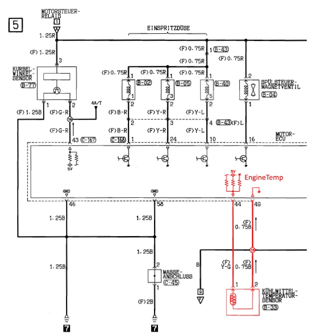

I'd like to connect the stock engine temp sensor (see attachement) - any chance to do that?

Now you have still one analog input left free (Adc2 0-5V), so you can connect signal from your stock coolant temperature sensor (ecu pin 44) to this input and it should work (sensor is already powered from ECU). You will need to scale it by measuring 2 voltages for 2 different temperatures, e.g:
20C = ... Volts
80C = ... Volts
and use excel from this thread viewtopic.php?f=28&t=58 to scale it (NTC U tab).
