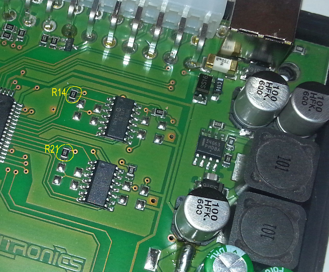

The other option is to modify AdcVccX inputs to AdcX input and then you can connect EGT5 and EGT6 to these inputs (EGT3/EGT4) so you will recoup Adc3 and Adc4 inputs. You will need to remove 2 resistors from UTCOMP-PRO board (R14 and R21 - I marked them on picture) and then AdcVcc1 and AdcVcc2 inputs will work as standard 0-5V AdcX inputs (without pullup).

Thank you ArT! That is very, very helpful.
