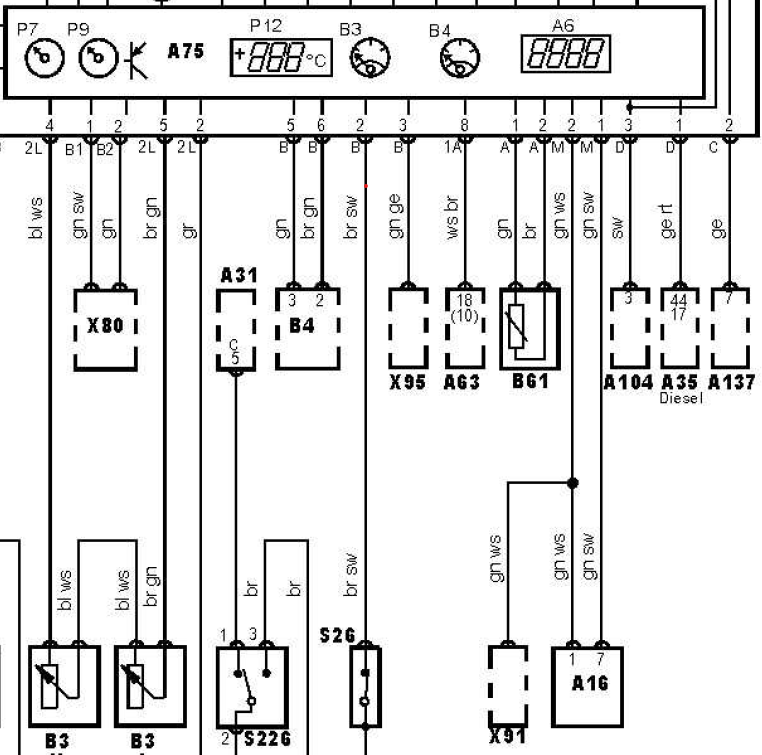

I want to buy UTCOMP-3, but before I need to know if my car has got all the wires needed to do it.
My car is a Mercedes Benz C280 Petrol Automatic (6L cylinders)1995'.

I know that the RPM and Fuel level wires are in a swith at the back of the Dashboard, but I don't know if that signal are the ones that UTCOMP requires.

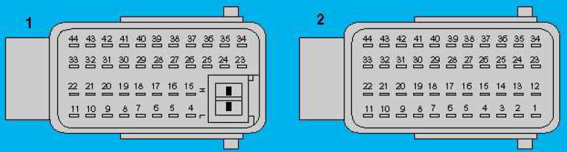

I don't know what wire (and where is it), for the fuel inyectors.

Hi Antonio,
Speed signal you can get from speed sensor (X91) or abs module (A16) - it's green white wire which is going to instrument cluster at pin M2:
2020-02-18 104142.png (204.75 KiB) Viewed 9539 times
Injector signal (for fuel consumption) you can get from any of injectors (directly) or any pin in ECU pin 23 or 13 or 2 or 3 or 12 or 24 socket 2:
2020-02-18 104319.png (82.72 KiB) Viewed 9539 times
2020-02-18 104412.png (127.38 KiB) Viewed 9539 times
