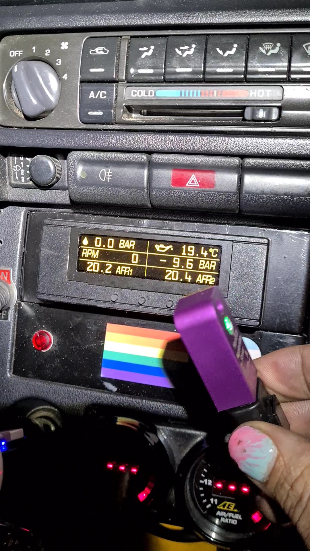

Hi
I'm using a g-force sensor with a 0-5v output.
-3g = 1v
0g = 2.5v
+3g = 4v
So I did 2* a -5 to get it to show properly..
I have connected it to adc2 and displayed it as a boost pressure..
I did (x10) put in 20*a - 50 to get a more accurate reading, faking a extra decimal..
But how do I add decimals instead. I want 2 decimals..
As in the picture -9.6 bar is 0.96G
And is there a easy way to change text from "BAR" to "G-force"?

You can change "BAR" icon but you will change it for all readings, please check details here:
viewtopic.php?f=28&t=54
You can have 2 digits accuracy for boost when you connect Android device with UTCOMP android app (details viewtopic.php?f=21&t=322) - unfortunately there is not such option on display - only for Lambda readings there are 2 digits after comma implemented on display (because there is only 1 digit before comma for lambda - for boost can be 2 digits before comma - in both cases 3 digits in total)
