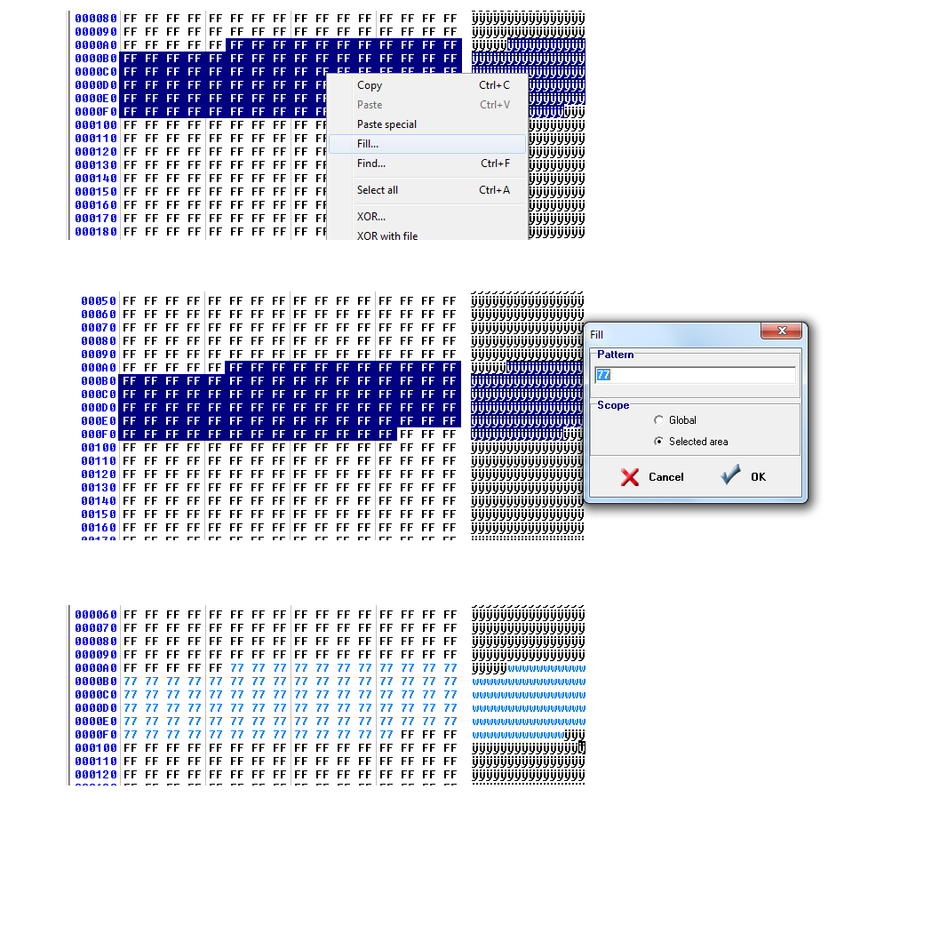

CHanges to program .... Buffer window copy/paste flaw etc...
Postby nunu78 » Thu Dec 03, 2015 1:21 pm
Need to make some adjustments to your program
1. When I paste into the buffer it ADDS the lines by shifting everything below - instead it should REPLACE
(if I copied from address 010 down to 040 and scrolled down and selected address 0200 and pasted it should REPLACE data from 0200 down to 0240 and NOT ADD to the buffer and shift the entire dump and size to say 95640
2. Select right click should have a FILL button to replace selected data with desired 00 or ff whatever
I would recommend making under FILL button >3 options -: will with FF, 00 and manual input. alot of ppl like to fill replace with FF or 00 all the time mostly used. and I dont want to type FF or 00 every time so that should be implemented by selection
3. When you select a Device say 95160 it should LOAD the buffer with all FF or open a blank buffer window and the size of the buffer should change with whatever the device you open.
4. Id like to change the COLOR of the hex, let users select the color they want to work with for each section ( data address) (hex view) ( ANSI view)

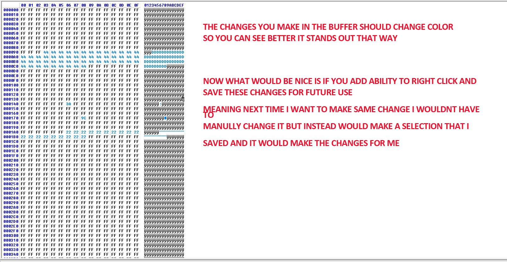

Data Change Calculator
Postby nunu78 » Thu Dec 03, 2015 1:31 pm
Your description says "car electronics & automotive (reprogramming modules, radio-code, immobilizers, gps navigations, mileage correction and other modules with serial EEPROM and/or FLASH memories),"
I would like to see a calculator implemented into this program that will allow users to write their own changes made in the buffer and store as a calculator for future use.
So lets say we read eeprom from 95040
in the buffer the changes I make manually by replacing the characters - I would like that data to change color so I know what I have replaced and where and then Right click and ADD TO CALCULATOR, - next time I read the same eeprom instead of doing the changes manually again I would open my saved calculator and click apply and it would make the changes.
THAT WOULD BE AWESOME
stream line the work flow
see pic
Re: CHanges to program .... Buffer window copy/paste flaw etc...
Postby ArT » Fri Dec 04, 2015 11:18 am
Re1: You need to select lines and then click paste to replace selected lines. If you do not select lines that it will paste & shift data.
Re3: You can click CTRL + N (it will fill buffer with 0xFF) or CTRL +R (it will fill buffer with random data)
Thank you for your suggestions.
Postby nunu78 » Fri Dec 04, 2015 2:28 pm
1st off , I did that IT STILL shifts data you have a FLAW
2nd what if I was copying large data size, now like an idiot i have to count the number of lines i copied and make that exact selection ????? And what if i make a mistake it would shift and add to the buffer Thats stupid
Regardless of ether you select it or not it should REPLACE and not shift and ADD
simple
see sample
fill
fill show4.png (42.19 KiB) Viewed 76267 times
nunu78
Posts: 15
Joined: Thu Dec 03, 2015 1:06 pm
Postby nunu78 » Fri Dec 04, 2015 2:32 pm
Your missing a point of the FILL
I need to SELECT highlight the data and fill that section with ether FF or 00 or user select like 01 or 3A NOT THE ENTIRE file.
So you should add - when RIGHT Clicked in the buffer under selected area ability to FILL with 3 options FF , 00, USER input

Re: Data Change Calculator
Postby nunu78 » Sun Dec 06, 2015 7:05 am
add this ability, ppl will love it
to store and save modified content for future use
Postby ArT » Sun Dec 06, 2015 7:21 pm
Thank you for your suggestions from this and other topics. We are working on few of these features. I'll let you know and share beta soft for tests when some of these functions will be implemented.

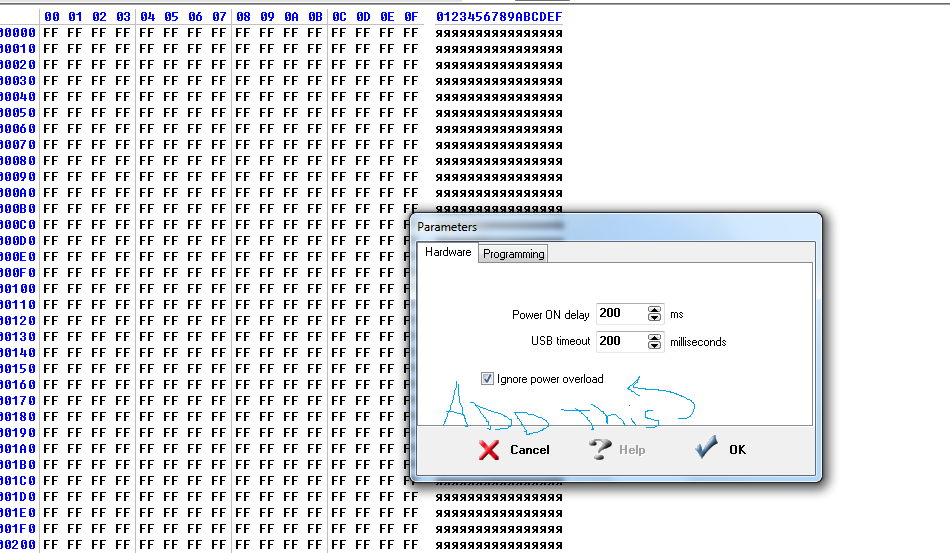

power overload - ON off please make
Postby nunu78 » Thu Dec 17, 2015 12:10 am
I tried Reading 95320 and it gives me that stupid 100mh protection
Please ADD ABILITY TO IGNORE POWER OVERLOAD - so I can select IGNORE and it will not show again regardless I dont need protection this should be optional for the user.
And NO not by selecting VPP OFF
make option to completely IGNORE with any voltage i select
Some EEPROM will NOT read unless you ignore the power overload, all I do is in circuit programming must make this option/ if needed make changes to your Hardware to support this option this is a MUST
