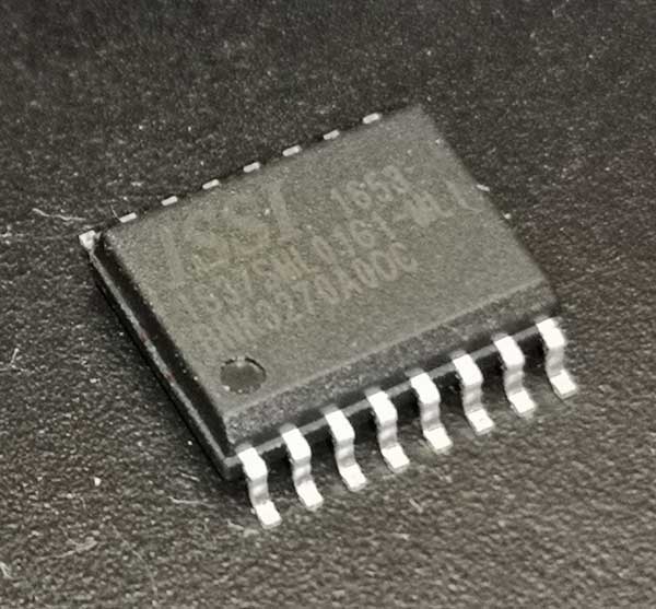

Hello! I'm looking for programmer for a such device:
Designation on package is ISSI IS37SML01G1-MLI
I have already your REVELPROG, and I'd like to ask is it possible to add support for this chip? If not, could you advice me programmer for this chip?
