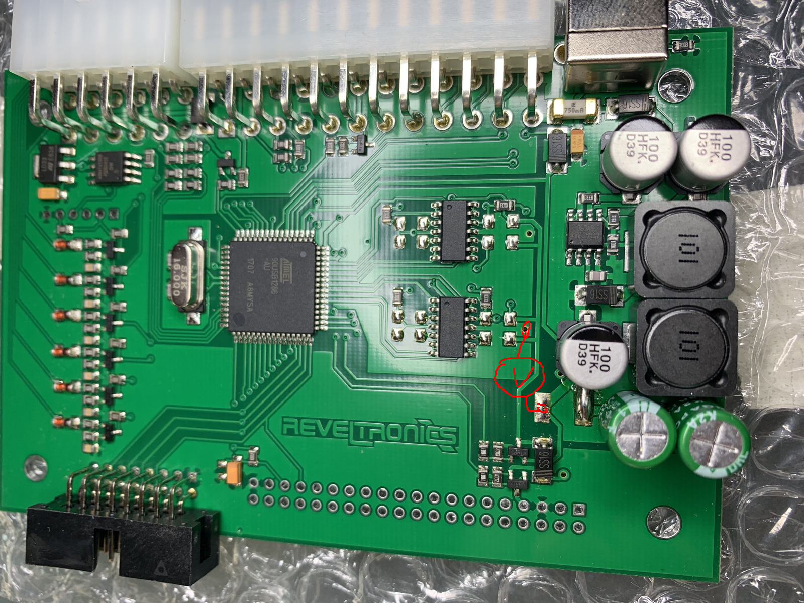

here is the display pcb
Image Image Image

Image Image Image Image Image
Re: UTCOMP Pro does not work anymore
Postby ArT » Fri Sep 10, 2021 11:19 am
Hi, please check the voltage on marked point. It's output from DC/DC converter and it should be around 5,2V.
If there is no 5V on this line, DC/DC converter is faulty.
If there is 5V on this line - please send me screenshot from application from "reading" tab with connected UTCOMP to vehicle and ignition switch ON. Please make sure that you have +12V on power supply.
NTC sensor should be connected to AdcVccX input with one wire, and second wire to ground. But connecting it to Adc1 can not damage it in any way.

Postby toho » Fri Sep 10, 2021 11:36 am
I measured constant 5,10V between the two marked points.
