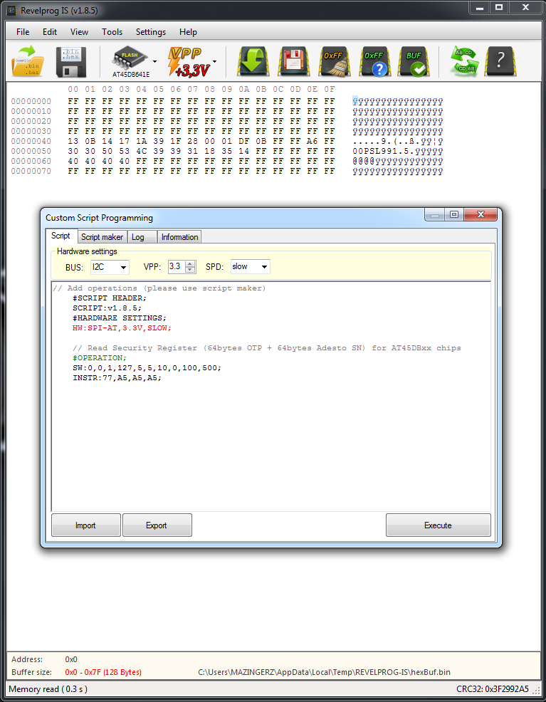

You can only write OTP bytes 0-63. You can not write bytes 64-127 - it's factory programmed (Adesto S/N). Your device does not have any data written in OTP user area (0-63 bytes). It has to be some protection mechanism before clonning. Based on data you have shared I can't figure it out, sorry :(

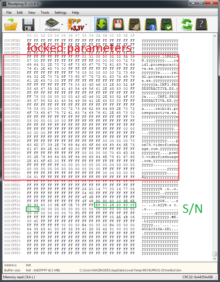

I enclose the link of the programming file .bin of the flash memory of the blocked alarm, as well as the images of the OTP reading and the blocked parameters, everything is from the same Adesto AT45DB641E flash memory.
In case you can get some more information as a last resort to see if anything else can be done.
Sin título.png (127.71 KiB) Viewed 8471 times
comandos lectura datos ocultos flash Adesto.png (108.24 KiB) Viewed 8471 times

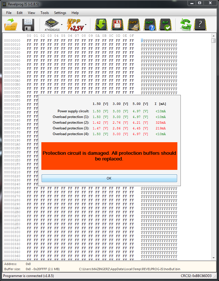

I have carried out a hardware test with the flash memory in the adapter, in this case AT45DB161E, and I obtain the result of the image that I attach
prueba hardware.png (110.66 KiB) Viewed 8390 times

If you made hardware test with disconnected inputs (with connected flash it will gives wrong results) it means that your protection buffers are damaged and programmer needs repair. They can be damaged during programming in external circuit in case of wrong connection. In such case please contact me via PM for procedure,

ArT wrote:If you made hardware test with disconnected inputs (with connected flash it will gives wrong results) it means that your protection buffers are damaged and programmer needs repair. They can be damaged during programming in external circuit in case of wrong connection. In such case please contact me via PM for procedure,
Hi Art,
My programmer is not damaged, I did that test with the flash memory connected directly to the adapter of the programmer.
I have to tell you that I can read the data from different flash memories correctly using 2.8V. So far I have fixed the bugs
