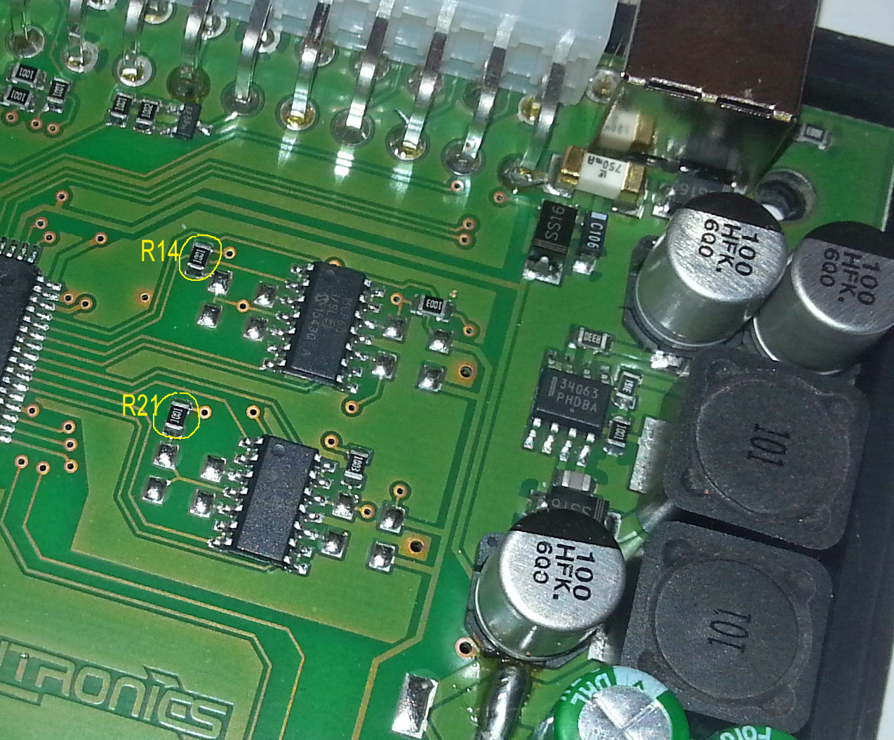

Additionaly, by default you can measure up to 4x EGT with UTCOMP-PRO, but if you modify 2 inputs from AdcVccX to AdcX then you can measure up to 6x EGT. For modification 2 internal resistors should be removed. We can do such modification before shipping or you can remove marked resistors, R14 is for AdcVcc1 and R21 is for AdcVcc2 input (removing them will change inputs to standard AdcX inputs required for EGT)

Hi ArT thank you, ill add the amplifiers egt-k 4 and egt-k 2 in with my order, ill add a note in shoping cart for you guys to "please remove the two resistors before shipping to run 6 egt". Thanks in advance
