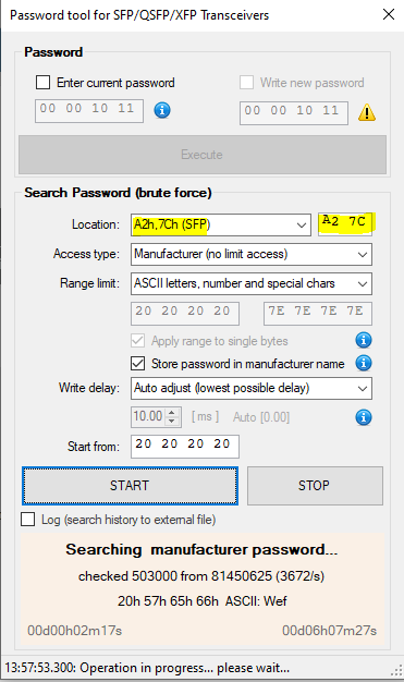

Is it just as simple as editing the options in the drop down and field to the right?

Yeah exactly, you can modify password location using these fields, right field is overwriting default value

The location you write is wrong.
Maybe you need to write "A2h FC" instead of "7C".
Best.

Just confirming, I would need to make sure that the second box reads exactly "A2h FC", not "A2 FC"?
And if so, then the suggested order of brute forcing would be:
"A2h 7Bh"
"A2h FCh"
"A2 7B"
"A2h FC"
Posts: 1572
Re: Seeking assistance. Locked? Can't find password?
Postby ArT » Wed Jun 19, 2024 9:26 am
A2h and A2 - these are the same address location
"h" means "hex", e.g. A2 in hex is represented as A2h or 0xA2 for clarification
