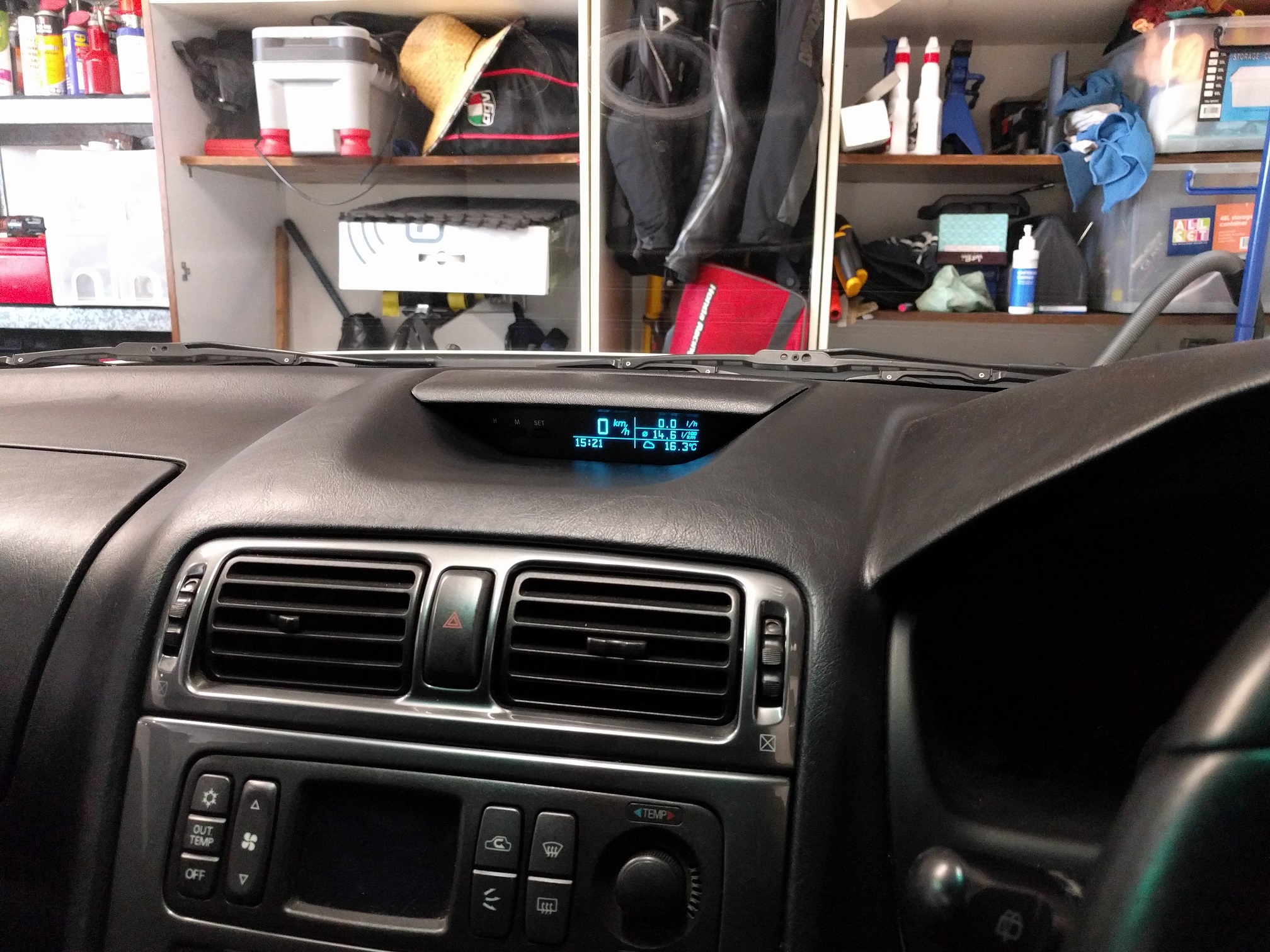

I'm in the middle of installing a UTCOMP-Pro to My 2001 Mitsubishi Legnum VR4 (twin turbo AWD 2.5 V6). I have it installed already and will update this post with images and so forth, but in the meantime I will use this post as a placeholder for the settings that work.
The UTCOMP screen replaces the factory clock. The clock holder pops out without any screws and is easily modified using a dremel to fit the OLED screen and allow for it to be secured using hot glue. The UTCOMP is mounted behind the console that surrounds the radio.
