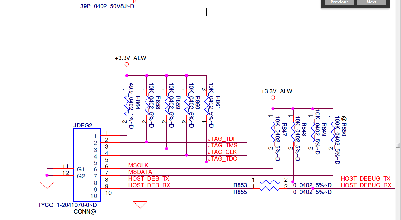

We need a toool for reading and writing JTAG on varios laptops . Can revelprog read and write on this bus ?
Regards , Vlad
jtag .PNG (85 KiB) Viewed 110647 times
Re: I2C SPI Custom Script Programming [TUTORIAL & EXAMPLES]
Postby ArT » Wed Jan 09, 2019 2:57 pm
Hi Vlad, unfortunately REVELPROG-IS does not support JTAG interface at the moment.

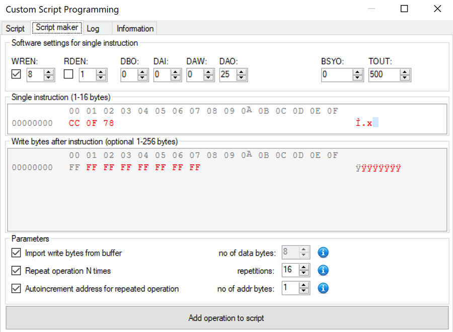

Since update v1.8.5 custom script tool will have some new features:
"DATA:BUFFER" in operations
It will import data bytes directly from application buffer, so you do not have type data bytes in script directly. Address will be incremented in background, so it will import bytes from buffer with proper offset. Example of use: (1) viewtopic.php?f=32&t=883 (2) viewtopic.php?f=32&t=436&p=2143#p2143
Script maker changes in v1.8.5
There are few new options:
  • Import write bytes from buffer -> it implements above "DATA:BUFFER" feature, instead of providing data bytes for writing in script, script can import these bytes in run time from buffer (during execution)
  • Reapeat operation N times -> you can generate multiple operations with single click (up to 256 repetitions). Address can be incremented automatically, please check option below
  • Autoincrement address for repeated operation -> you need to specify number of address bytes (1, 2, 3 or 4). Address will be incremented in repeated operation (address bytes = 1,2,3 or 4 last bytes in instruction).
On below example Instruction is CCh 0Fh 78h where 78h is address (single byte address). This address will be incremented in repeated operation, so first operation will have address 78h, second will have 80h (78h + number of bytes to write = 8 in this example), third will be 88h etc. "Write bytes after instruction" window is disabled because "import write bytes from buffer" option is checked (it will import bytes from buffer during script execution).
