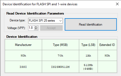

I want to program a MT25QU256ABA1EW9-0SIT SPI flash with your WDFN8 adapter. The device is not recognized and read identification delivers FF only, also a second device. Both devices are new.
An IS25WP512M device is detected and can be programmed with the same adapter. The software is V1.9.1.

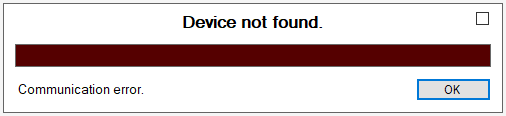

with 2,0V the device it detected every time. Programming starts with erase and then it fails at programming

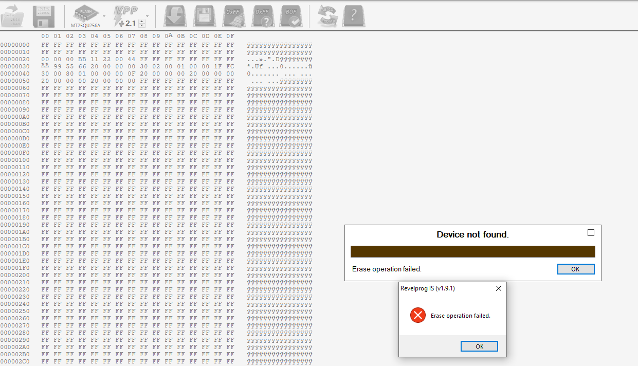

Erase and blank check works with 2,0V. With 2,1V it also does not work and it brings up strange messagebox "...".
I ordered a new Revelprog and check then.
