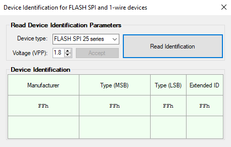

Dear Revelprog Team,
I want to program a MT25QU256ABA1EW9-0SIT SPI flash with your WDFN8 adapter. The device is not recognized and read identification delivers FF only, also a second device. Both devices are new.
An IS25WP512M device is detected and can be programmed with the same adapter. The software is V1.9.1.

If IS25WP512M is working then adapter and programmer are fine - the same chip ID procedures are for MT25 series.
Please check pad contact for MT25. You can check also at slightly higher voltage, e.g. 2.0 volts - any difference?
What is effect when you click read memory when MT25QU256A is selected? Communication error or it reads memory?

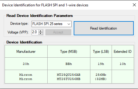

Postby woko » Mon Nov 20, 2023 8:36 am
with 2,0V the device it detected every time. Programming starts with erase and then it fails at programming

Postby woko » Fri Nov 24, 2023 8:05 am
Dear Artur, I just received the new revelprog. With VPP 1.8V (default) erase fails, detection is ok. With VPP 1.9V erase/programming/verify is good!
